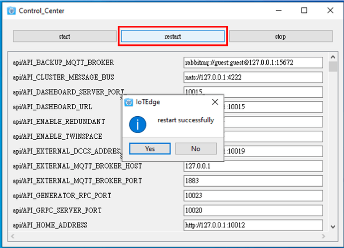

1.Run Control Center as Administrator
2.Restart IoT Edge Services

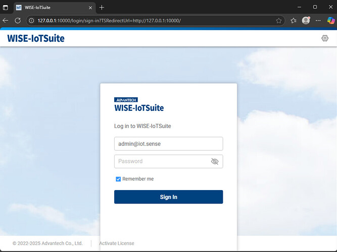

4.Check if the login page loads successfully
