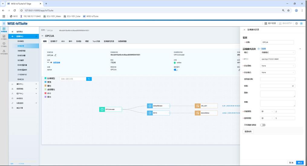

How to use IOTedge to connect adam6317 OPCUA

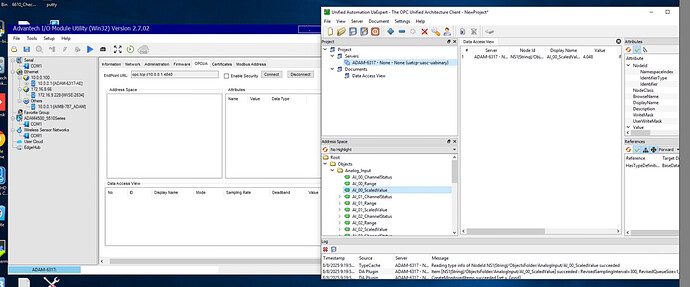

1. Use OPCUA anonymous to login directly , port is 4840
Input opc.tpc://ip:4840

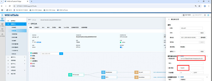

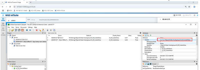

Copy address, paste IOTedg tag’s address
Then can see tag value on IOTedge
