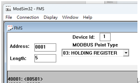

Write back value
User can see address value was change to 501
