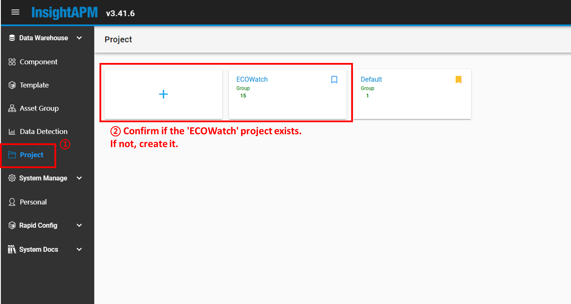

Steps to Resolve Data Display Issue:
  1. Check Project Management for “ECOWatch”:
    First, confirm if the “ECOWatch” project exists in the project management section. If it does not, you need to create a new project with the name “ECOWatch.”

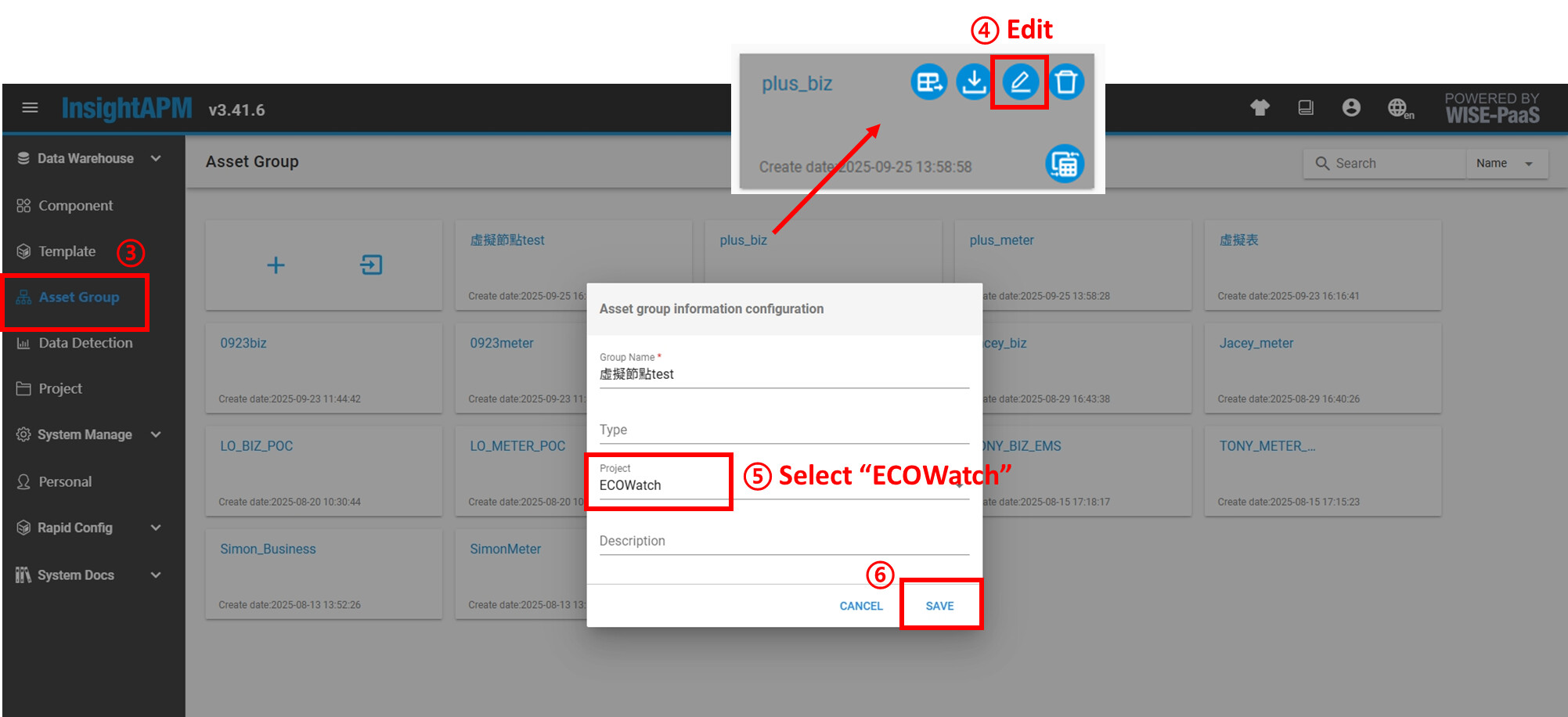

  2. Move Asset Groups to “ECOWatch” Project:
    Once the project is set up, navigate to the Asset Group Management section. Move the created meter and business asset groups to the “ECOWatch” project for proper grouping.
