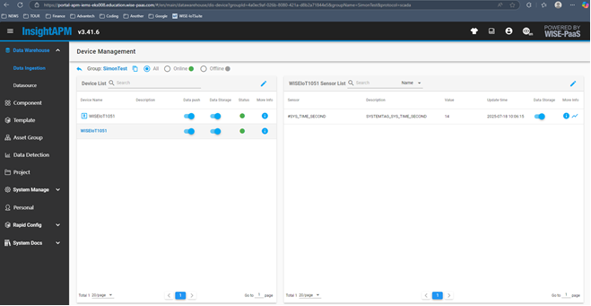

Then tick the tag is ready to upload and download settings into ECU gateway.
Result:
