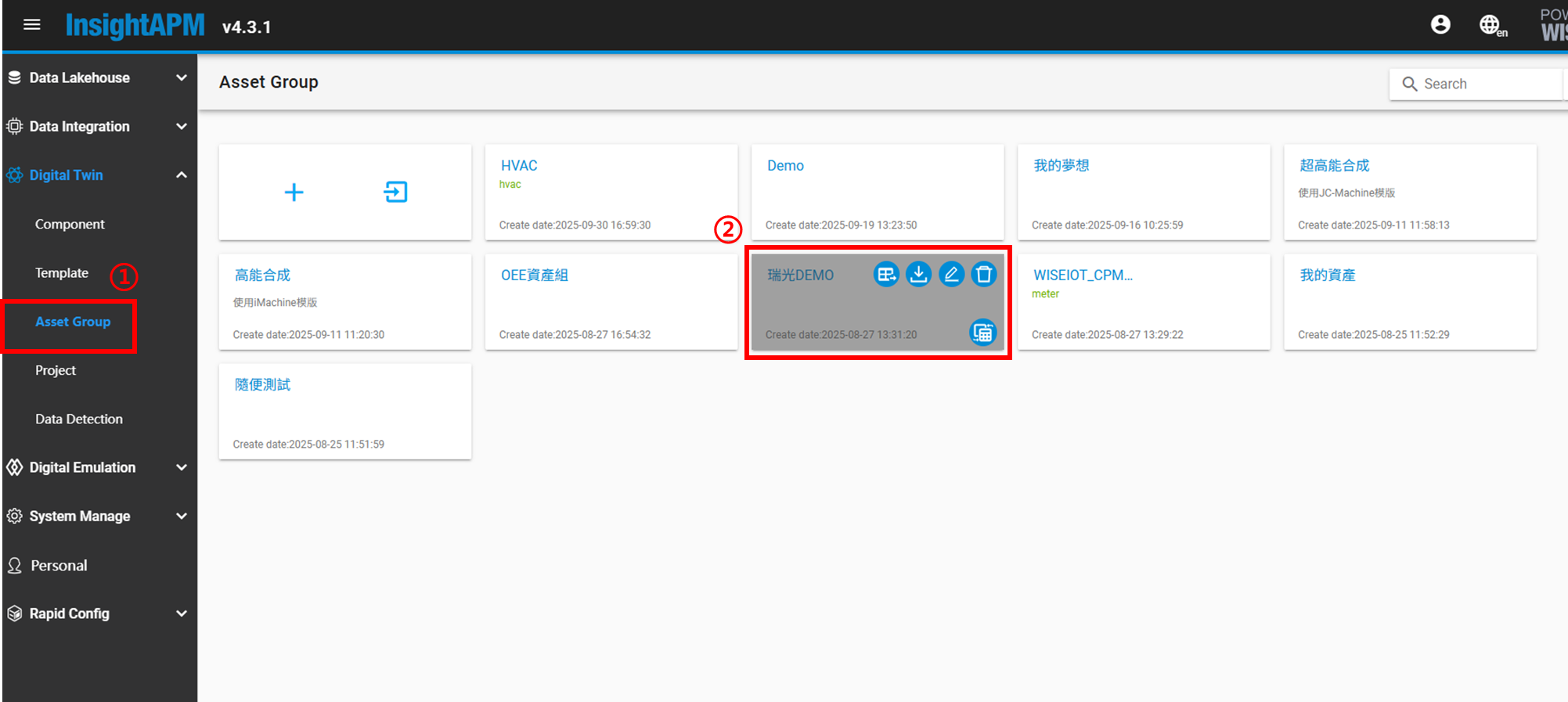

Enter InsightAPM, locate the business asset group, and click to enter the edit screen.

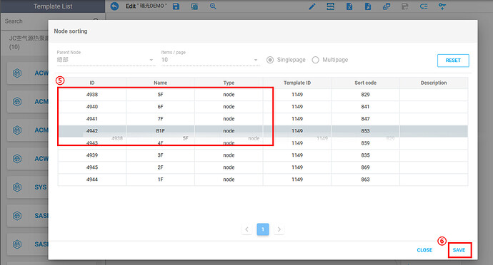

Find the parent node you want to reorder.
2000×943 204 KB
Drag the node to reorder it, then save.

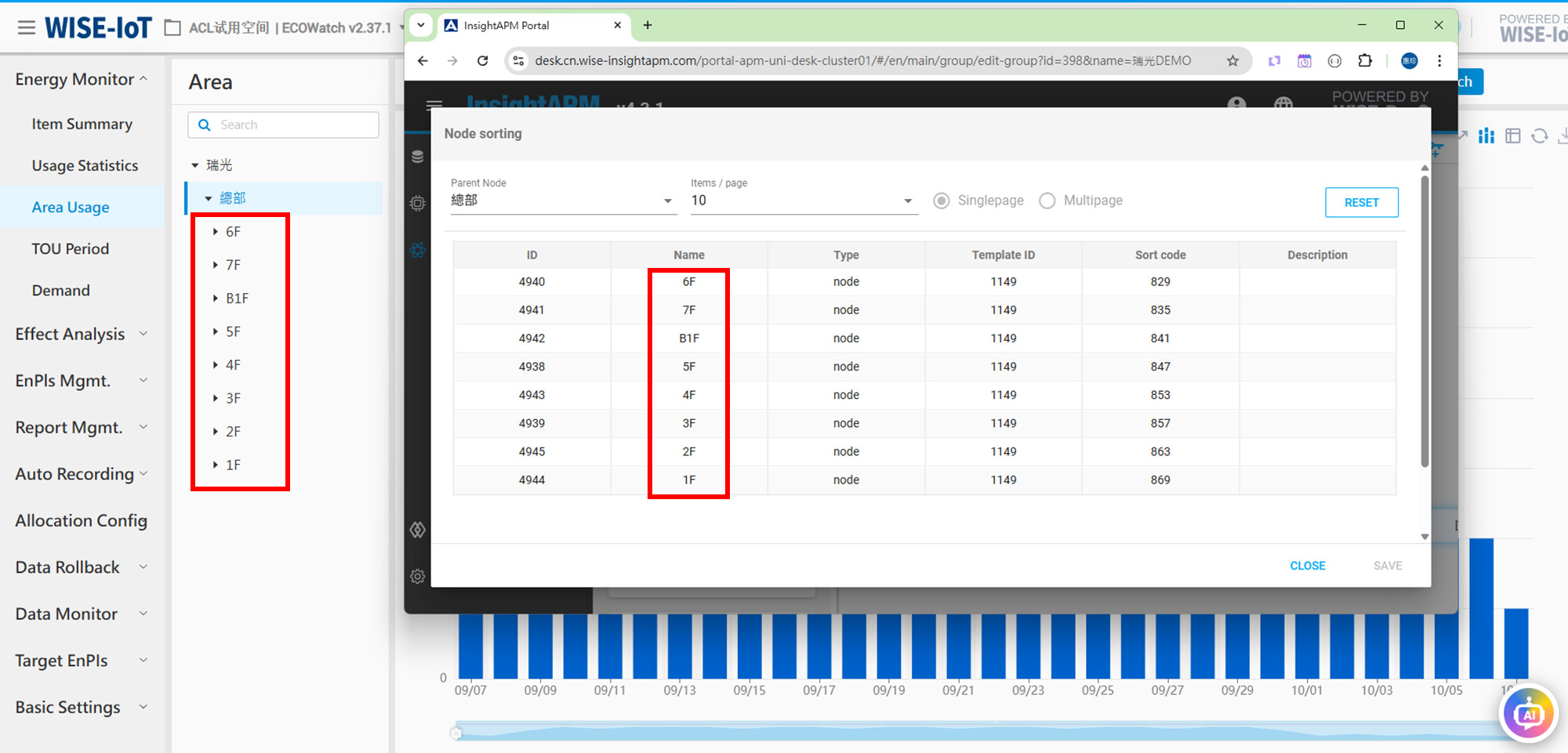

Return to the ECOWatch frontend and refresh the page to confirm the result.
